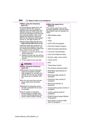

Everything you need to know about maintaining your spare tire - from checking pressure to understanding when it's safe to use. This guide pulls together information scattered across your manual into one place.
(Reference: Owner's Manual, pg. 532, 594, 620)
Remember that the temporary spare tire provided is specifically designed for use with your vehicle. Do not use your temporary spare tire on another vehicle.
Do not use more than one temporary spare tires simultaneously.
Replace the temporary spare tire with a standard tire as soon as possible.
Avoid sudden acceleration, abrupt steering, sudden braking and shifting operations that cause sudden engine braking.
Source: Owner's Manual pages 594

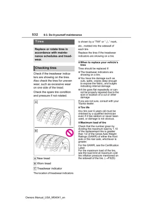

Tires are one of the most critical safety components of your vehicle. Regular inspections and timely replacement keep you safe on the road. Replace tires when any of the following conditions are present:
Treadwear Indicators Showing
The treadwear indicators are showing on a tire. These are small raised sections molded into the sidewall of each tire and marked with "TWI" or a similar symbol. When the tire tread wears down to the level of these indicators, replacement is mandatory.
Visible Damage
You have tire damage such as:
Repair Limitations
A tire goes flat repeatedly or cannot be properly repaired due to the size or location of a cut or other damage. Even minor damage can sometimes lead to repeated air loss if the damage is in a location that prevents effective repair.
Age-Based Replacement (Critical)
Any tire over 6 years old must be checked by a qualified technician even if it has seldom or never been used, or damage is not obvious. Tire rubber degrades over time regardless of use, and this age-based policy is essential for safety.
Tire Load Capacity Verification
Replacement tires must meet or exceed your vehicle's load requirements. Check that the number given by dividing the maximum load by 1.10 of the replacement tire is greater than 1/2 of the Gross Axle Weight Ratings (GAWR) of either the front axle or the rear axle, whichever is greater. You can find the GAWR on the Certification Label inside the driver's door jamb, and the tire's maximum load rating on the sidewall.
When in doubt about replacement criteria, your Toyota dealer can help.
Source: Owner's Manual page 532
Your Tacoma comes with a temporary spare rather than a full-size spare. It's designed specifically for your truck and differs from standard tires in a few important ways:
The temporary spare tire is not equipped with the tire pressure warning valve and transmitter. This creates two important limitations:
Source: Owner's Manual page 594
When you have a flat tire and need to install the temporary spare:
If you have a flat rear tire on a road covered with snow or ice, follow this modified procedure to maintain traction and stability:
This procedure maintains better traction at the rear wheels while using the temporary spare at the front.
When the temporary spare tire is installed and the vehicle is driven, the following systems may not operate correctly due to the difference in tire diameter and the lack of TPMS monitoring:
Safety Systems Affected:
Convenience Features Affected:
Visibility/Navigation Systems Affected:
Because of these limitations, avoid sudden acceleration, abrupt steering, sudden braking, and shifting operations that cause sudden engine braking.

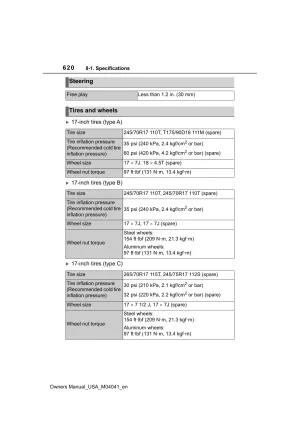

Your vehicle may be equipped with one of three tire and wheel configurations. Use these specifications to verify you have the correct tire pressure and wheel nut torque for your specific vehicle:
Configuration Type A (17-inch Standard Tires)
Configuration Type B (17-inch Standard Match)
Configuration Type C (17-inch Larger Alternative)
Note: All tire inflation pressures are recommended cold pressure values. Check tire pressure when the vehicle has been parked for at least 3 hours or when the vehicle has been driven less than 1 mile at moderate speed.
Source: Owner's Manual page 620

Understanding Tire Maintenance and Replacement
When to Replace Your Vehicle's Tires
Visible Damage
- Cuts or splits in the sidewall or tread
- Cracks deep enough to expose the fabric
- Bulges indicating internal damage
Repair Limitations
Temporary Spare Tire System
What is a Temporary Spare Tire?
- Size: T175/90D18 or 245/70R17 (depending on configuration)
- Inflation Pressure: 60 psi (420 kPa) or 32 psi (220 kPa) cold pressure (significantly higher than standard tires)
- Wheel Size: 18 × 4.5T, 17 × 7J (dedicated spare wheel)
- Duration: Temporary use only - designed as a get-you-home solution
IMPORTANT: Tire Pressure Monitoring System (TPMS) Incompatibility
- Low Pressure Not Detected: Low inflation pressure of the spare tire will not be indicated by the tire pressure warning system.
- Warning Light Persistence: If you replace the temporary spare tire after the tire pressure warning light comes on, the light will remain on until the system is reset or the standard tire is reinstalled.
Using the Temporary Spare Tire
Standard Procedure
- Safely move your vehicle away from traffic
- Engage the parking brake
- Remove the temporary spare tire and wheel from the trunk
- Use the jack to lift the vehicle (follow the jack positioning in your owner's manual)
- Remove the wheel lugs using the wrench
- Remove the flat tire
- Install the temporary spare tire on the hub
- Hand-tighten the wheel lugs, then lower the vehicle
- Torque the wheel lugs to specification (see Specifications section below)
Special Procedure: Flat Rear Tire on Snow or Ice
- Install the temporary spare tire on one of the front wheels of the vehicle (do not install on the rear)
- Remove the undamaged tire from the front and install it on the rear where the flat tire was located
- Fit tire chains to the rear tires for traction in the snow/ice conditions
System Limitations When Spare Tire is Installed
- ABS (Anti-lock Braking System) & Brake Assist
- VSC (Vehicle Stability Control)
- TRAC (Traction Control)
- AUTO LSD (Automatic Limited-Slip Differential) if equipped
- PCS (Pre-Collision System)
- AHB (Automatic High Beam) if equipped
- LTA (Lane Tracing Assist)
- LDA (Lane Departure Alert)
- Trailer Sway Control if equipped
- PKSB (Parking Support Brake) if equipped
- Dynamic Radar Cruise Control
- Cruise Control
- EPS (Electronic Power Steering)
- Tire Pressure Warning System
- BSM (Blind Spot Monitor) if equipped
- RSA (Road Sign Assist) if equipped
- RCTA (Rear Crossing Traffic Alert) if equipped
- Panoramic View Monitor if equipped
- Multi-terrain Monitor if equipped
- Toyota Parking Assist Monitor if equipped
- Intuitive Parking Assist if equipped
Technical Specifications
Tire and Wheel Configurations
| Specification | Standard Tire | Spare Tire |
| Tire Size | 245/70R17 110T | T175/90D18 111M |
| Tire Inflation Pressure | 35 psi (240 kPa, 2.4 kgf/cm²) | 60 psi (420 kPa, 4.2 kgf/cm²) |
| Wheel Size | 17 × 7J | 18 × 4.5T |
| Wheel Nut Torque | 97 ft·lbf (131 N·m, 13.4 kgf·m) | 97 ft·lbf (131 N·m, 13.4 kgf·m) |
| Tire Size | 245/70R17 110T | 245/70R17 110T |
| Tire Inflation Pressure | 35 psi (240 kPa, 2.4 kgf/cm²) | 35 psi (240 kPa, 2.4 kgf/cm²) |
| Wheel Size | 17 × 7J | 17 × 7J |
| Wheel Nut Torque (Steel) | 154 ft·lbf (209 N·m, 21.3 kgf·m) | 154 ft·lbf (209 N·m, 21.3 kgf·m) |
| Wheel Nut Torque (Aluminum) | 97 ft·lbf (131 N·m, 13.4 kgf·m) | 97 ft·lbf (131 N·m, 13.4 kgf·m) |
| Tire Size | 265/70R17 115T | 245/75R17 112S |
| Tire Inflation Pressure | 30 psi (210 kPa, 2.1 kgf/cm²) | 32 psi (220 kPa, 2.2 kgf/cm²) |
| Wheel Size | 17 × 7½J | 17 × 7J |

Understanding Pressure Requirements
The temporary spare tire requires significantly higher inflation pressure (60 psi or 32 psi depending on configuration) compared to standard tires (30-35 psi). This higher pressure is necessary because the smaller temporary spare wheel cannot support the vehicle's weight at standard tire pressures. The higher pressure compensates for the smaller wheel diameter and the altered weight distribution.
Always verify the correct pressure for your specific configuration on your door jamb sticker. Incorrect pressure on a temporary spare is a safety hazard.
Source: OEM specifications + community confirmation
Tire Age and Storage Considerations
The 6-year replacement rule for tires older than that applies to all tires, including spare tires. If your temporary spare has been installed for 6 years, even if it hasn't been driven on, it should be checked by a qualified technician. Rubber degrades due to UV exposure, ozone, temperature cycling, and oxidation regardless of vehicle use.
Real-World Extended Spare Use
Although the manual says "replace the temporary spare tire with a standard tire as soon as possible," manufacturers recommend following the industry-standard 50-70 mile maximum limit for emergency use. Some owners do use a temporary spare for extended periods beyond this guideline. If you exceed the standard distance, understand that system safety features are compromised, fuel economy may decrease due to altered tire diameter and increased rolling resistance, and handling characteristics change. Extended use beyond the recommended 50-70 mile limit may stress suspension components designed for the lighter load of a temporary spare.
Source: Industry standards + Toyota Owner's Manual guidance

- Full treadwear assessment on temporary spare (penny test)
- Check for signs of aging or UV damage on sidewalls

- Temporary spare tire procedures and system limitations: Page 594
- Tire specifications and wheel nut torque: Page 620
