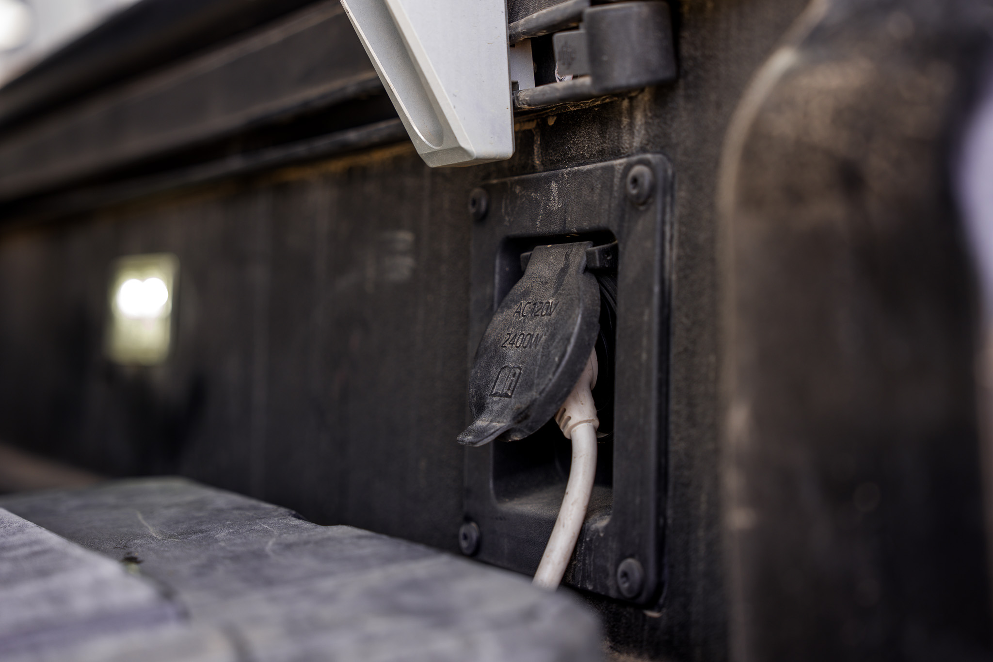

The 2400W inverter on the i-FORCE MAX Tacoma sounds amazing on paper. And honestly, 90% of the time it IS amazing. I've been running a Starlink Mini off the bed outlet full time for 32,000 miles — streaming, camping, highway, rock trails. Temps from -15°F to 118°F.

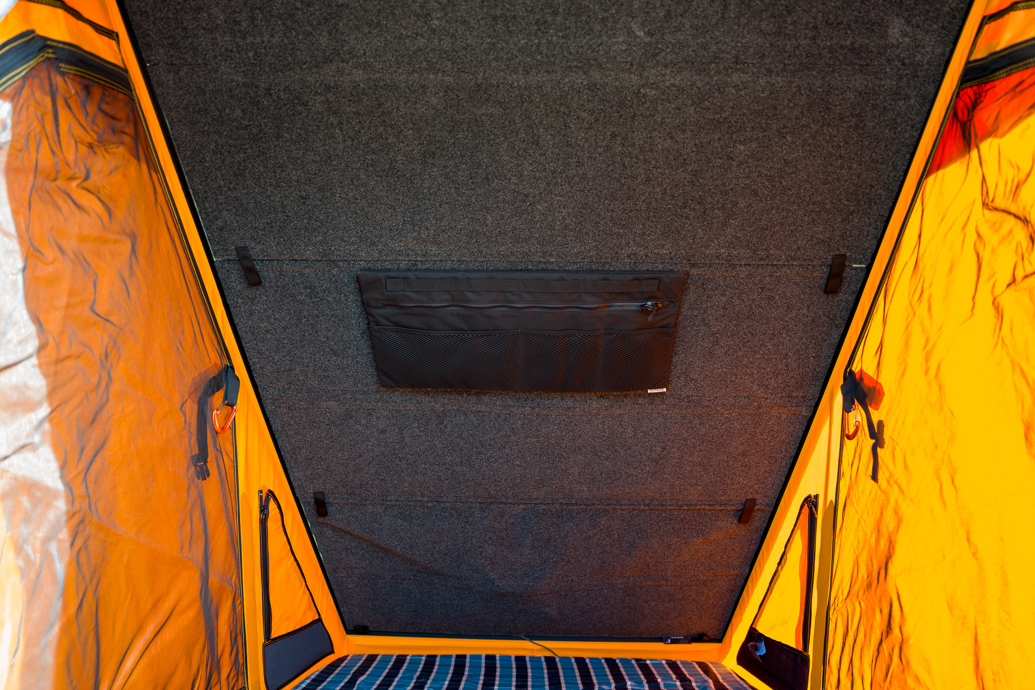

Starlink Mini lives inside the GFC V2 Pro, suction-cup mounted to the ceiling, hidden under the headliner. Power cable runs from the 120V bed outlet through the floor panels. From outside you'd never know it's there.

If the battery drops low enough, moving the truck down the road always wins over whatever you've got plugged into the bed outlet. Starlink reboots. Connection gone.

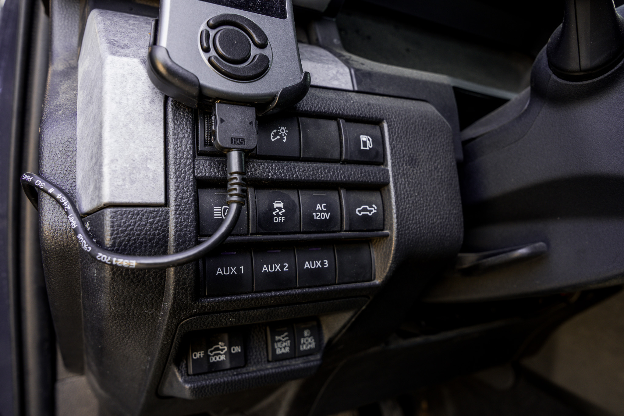

4. Portals + Sport/Tow-Haul + CAMTuning flash = SOLVED
The custom tune via COBB Accessport was the last piece. Optimized shift logic + portal gearing + aggressive drive mode = the engine produces enough power to climb, charge, and run the inverter simultaneously. Battery gauge stays stable through grades that previously caused depletion. Starlink stays connected the whole drive.
