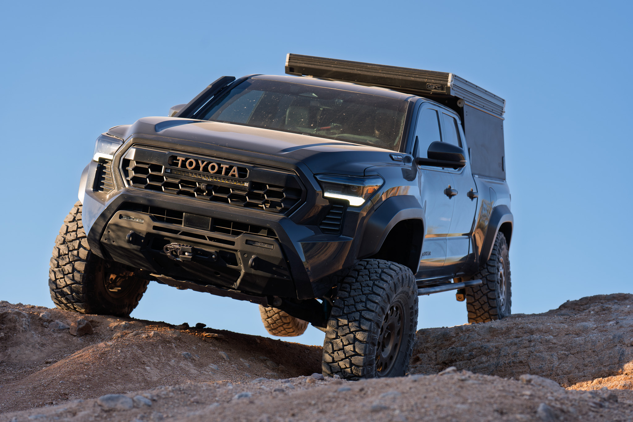

A custom calibration starts with your data. You flash an initial map, drive, send logs, and the tuner reads exactly how your ECU is responding. Then they revise. Each round tightens the calibration to your specific setup. My Trailhunter with 74Weld portals and 37s needs a fundamentally different tune than a stock TRD Off-Road.

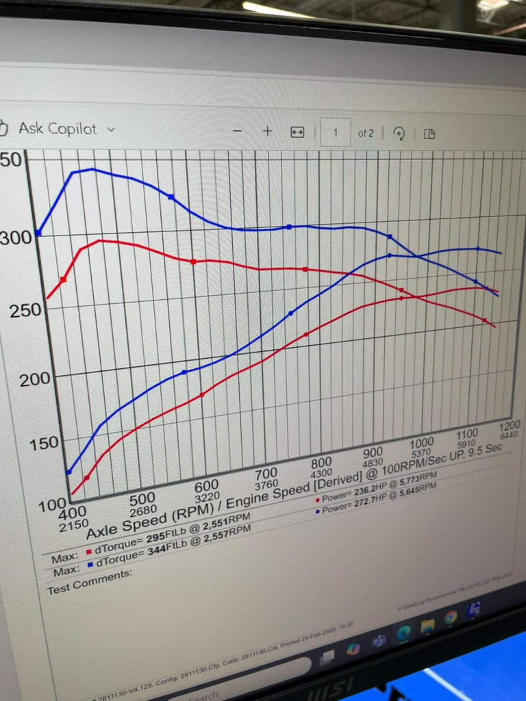

Hub dyno at SDHQ. Wheel numbers (not crank):
Stock tune: 246 HP / 349 ft-lb torque
Custom calibration: 295 HP / 413 ft-lb torque
Gain: +49 HP / +64 ft-lb
Beyond the raw numbers — torque peak moved from ~2,950 RPM down to ~2,775 RPM. Max torque arrives sooner, exactly what you want on a loaded truck with portals and 37s. The power curve is also broader through the midrange instead of falling off sharply after peak.
