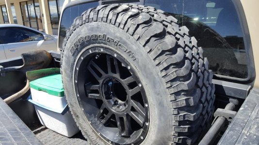

If you’re like me and always pack two spare tires, here’s a simple way to mount that second one.
The first image displays the parts I used: just an 8-inch 3/8 x 16 bolt, some washers, a lock washer, and a 3/8 threaded t-nut.
Slide the t-nut into the bed rail track, rotate the tire to align two lug nut holes with the track, then slip the bolt through. It’s rock-solid and budget-friendly.
