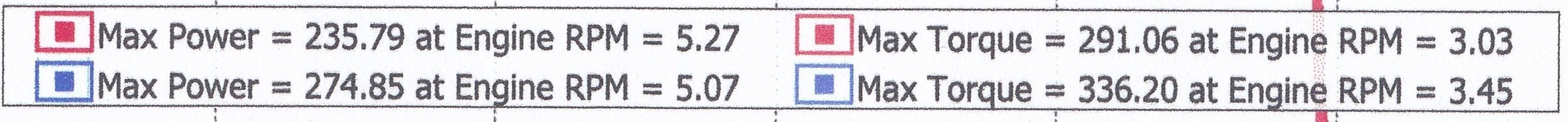

I had my TRD-OR 6MT dyno tuned today by https://www.camtuningperformance.com/. Cam came over to the house on Saturday after a club breakfast, and did a minor tune on my truck. Today, he did his dyno tune. I was pleased after the minor tune he did on Saturday. I was super impressed driving home this afternoon after the dyno tune. I can't wait to get the truck on the road for another adventure.
This was on 91 octane and 285/70 tires.

After Cam did a driveway tune on Saturday we went for a putt. The first thing I noticed was throttle response from a standing stop. With the 285/70's and the camper the truck was a slug to get moving. Not any more. The difference between before and after was huge. The truck has a lot more pep across the board.
One thing I learned is Toyota "de-rated" the manual trucks. They make slightly less power (-8hp) than the automatics, and the redline on the manual trucks is way less (~5200rpm vs 6600rpm). For some reason Toyota did this to make the EPA happy (emission purposes). Cam raised my redline to the automatic spec along with a bunch of programming voodoo.

Some the the black magic Cam did was tweek the boost. Both the amount and the timing.
