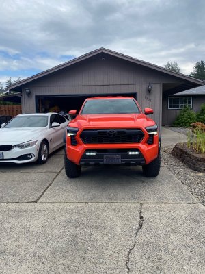

Confirmed true plug and play, direct swap from a TRD Pro to base level Solar octane Offroad yesterday. Very happy with the look and functionality.
Headlight tilt adjustments, Amber sequential DRLs, and day time white DRLs work!
No special harnesses or reprogramming needed. You can see that Toyota will eventually make these standard on later model years given the direct swap.
Definitely worth it if you can find a pair for a good price. Got mine for $650 locally!
Main difference is instead of a socket for the halogen bulb, it now plugs into the DRL plug in which must codes for the sequential turn signals and daytime running lights. Nothing illuminates in the once halogen bulb area part of the headlight. Hope this helps clear up the confusion a lot of us had. Toyota parts website notes these as not compatible but the schematics are exactly the same.

I really like my lights, I think the sequential part looks really good. Now you should replace that black cover under yours lights. I found these and the turn signal is also sequential. Really compliments the OEM lights I think. My buddy has a sport and we put them on his. Would be a real easy job if those covers were no so hard to removed. Ended up just cutting them off, much easier.

$650, bro that’s a really good deal. I want to my upgrade my but on Ebay I found a lot of knockoffs for $700 for the pair.
Did you use Facebook marketplace or OfferUp?
Looks amazing 🤩.
Dang $650 is HYPE! They look great...and I love the color of your truck. I think I'll end up swapping at some point if I can find a deal like that.
Haha and the seller was super hype too, we installed them in his driveway. Definitely worth it for a deal but would never go out of my way for them above a 1k asking price (mind as well go Alpha or wait for Form)
Looks amazing 🤩.
I used Marketplace and luckily it was a guy who uses the forums regularly as well. Installed in his driveway. Definitely worth it for a good deal! Thanks man
