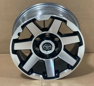

Hey guys so I have a set of Toyota 4Runner trail rims on my tacoma currently right now and also have a westcott 2.5 Level/lift, I wanted to run 285/75R17 but some say that it'll cause rubbing and I don't really feel like cutting up a brand new truck, just wondering if anyone has any similar setups on their taco, I believe the offset on my rims are +15 other than that they are 17x7.5 ill include a picture. any help appreciated.
You might have some minor rubbing. But a positive offset with a 34" tire is on the less likely side to need any bigger cutting/trimming. Are you planning on off-roading at all or just driving on the street? Things usually rub a lot worse off-road.
I would say my off-roading level is a medium, I don’t do it everyday but I like go out once in awhile, if it’s a huge problem, should I wait to upgrade to a 3.5 kit then just throw 35’s 🤔
