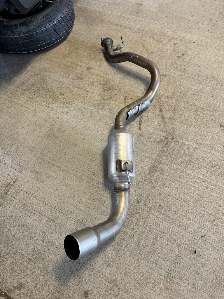

View attachment IMG_4448.jpegSCRAPES, DENTS, AND DINGS OH MY!​

Out with the old (and bulky)
DESIGN AND CONSTRUCTION​
The Toyota Tacoma Axle Dump Exhaust Tip is made with 2.75 inch diameter titanium tubing. This exhaust tip is available for all trims of the 2024 Tacoma (with the exception of the trail hunter), and replaces the factory rear (axle back) section of the exhaust, providing extra clearance for off-road usage, as well as enhanced exhaust sound and 15 lbs of weight savings.

All that is required to install the exhaust tip is a 14mm wrench or socket. There are only 2 bolts to take off, put the exhaust tip back on, and tighten the bolts back on.

Nice, but I found it easier to just cut the pipe at a 45 degree angle just past the resonator. I like the much cleaner look too, have done this to many of my trucks of the years with never any issues. Used high heat black paint on everything that was showing with the muffler.
