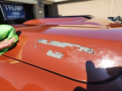

If you heat the letters with a heat gun, the adhesive on the backside will slowly loosen. Then, take some fishing line and run it down the backside of the emblems to pull them off. Repeat until the emblem is off. Then you can peel off all the adhesive with your fingers until there is only residue left. Then use some brake cleaner or carb clean (BE CAREFUL and FAST). Spray it on a microfiber towel, not the paint directly, and quickly wipe off the residue
The brake cleaner was a trick I learned from a detailer who uses it to get thick road grime off paint. It works super well, but you're definitely not supposed to spray it directly on paint or leave it on very long. You're really not supposed to use it on paint at all but it does work incredibly well. Do it at your own risk. lol. That said, I've never had any problems with this method.

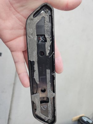

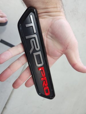

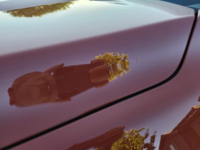

I can confirm Double-Stick tape used on these... Badges successfully removed, looks better w/o, in my opinion.

I liked them too, but easier to clean & dry the truck w/o all the stickers/badging. Also, I feel the badging for TRD pro was over the top with all the places they slapped the logo and it gives it a cleaner look.
I even removed the iForce logos from the tailgate.
