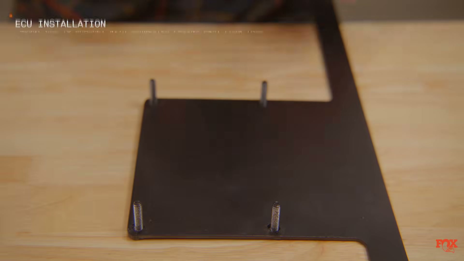

- ECU — the brain. Runs Fox's "Live IQ" algorithm. Mounts under the driver's side carpet, sandwiched between the seat bolts and the floor.

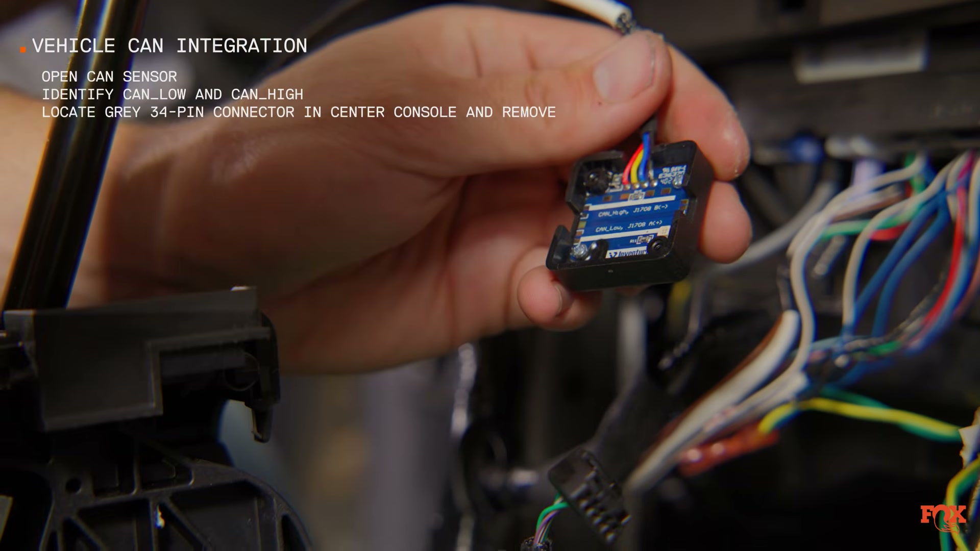

- CAN sensor — taps into the truck's data network. Reads speed, steering angle, brake pressure, and throttle. Clamps onto two wires on a 34-pin connector. No cutting, no splicing.

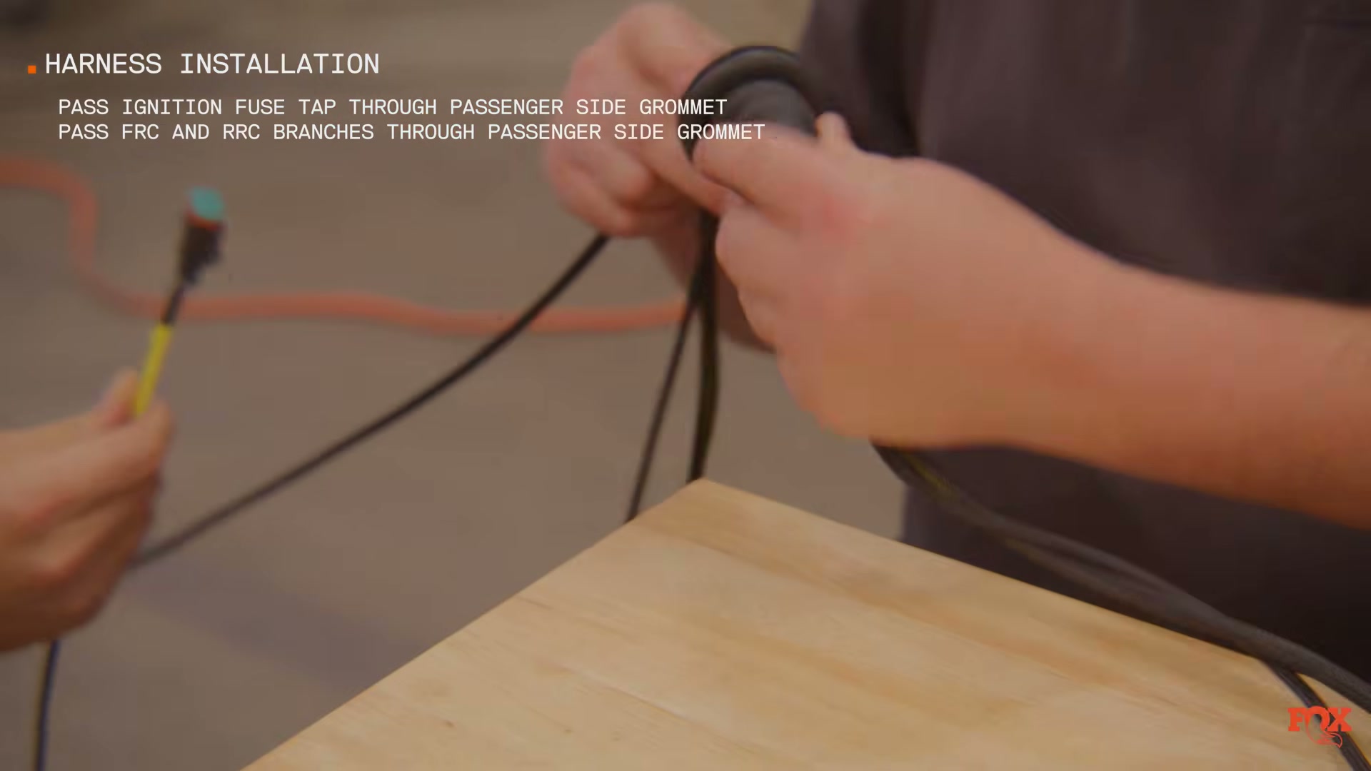

- Full wiring loom — labeled branches to all four corners. Routes through the cab floor to the frame rails.

The electrical side is where it gets real. Fox's video runs 19 minutes. Both front seats come out. Entire center console gets pulled. Gear selector removed. Wiring routes through holes in the cab floor, down the frame rails to each shock. You're tapping into the CAN bus, mounting the IMU, bolting the ECU under the carpet, running power to the hybrid battery under the rear seat, and tapping the ignition fuse at slot F5. SDHQ is handling my install. Plan 5-6 hours for the electrical side alone if you're doing it yourself.
