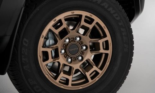

Y'all think these will fit?

I've really wanted bronze wheels for my Underground TRD OR and i've always thought the Method 703's looked the best but i was at work and someone was driving a 3rd gen with these wheels on them (attached). I thought they looked sick and they looked factory. I found out that they are 40th Anniversary 4Runner wheels but I'm thinking maybe they will fit on the 4th gen Taco and look sick. What do y'all think?

They will fit but you’ll need the correct lug nuts to fit 2/3 gen wheels on the 4th gen. I can’t remember where I seen them for sale? But I know they are available.

We tried to fit a set of 5G 4Runner TRD wheels. It did not work. From my understanding, the OEM wheels are really difficult to put on newer gens. One issue, you need a hub adapter for larger diameter hub. That part is easy. But then the issue is, the lug nuts are larger on the new Tacoma. To my knowledge, no one makes a lug nut that will actually work here. The only solution I've seen are adapter spacers, but they can get expensive because it's a custom job.
Found em!
Why does Rusty gotta make me nervous saying they don't fit and now Cold says they do lol. I gotta find someone who has those wheels and ill try to see if they fit. Probably pretty hard out in the hill country of Texas lol.

These are the ticket!
I take it back! The link he posted earlier looks to be the right one. First time seeing that.
