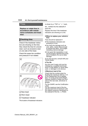

Safety Precautions
Tire Age Limit: 6 Years
Even if a tire looks fine, it degrades over time. Any tire older than 6 years needs a professional inspection before you keep using it - rubber dries out and can fail without warning, regardless of tread depth.
When to Replace Your Tires (Safety First)
Replace your tires if you notice any of these signs:
- The treadwear indicators are showing on a tire
- You have tire damage such as cuts, splits, cracks deep enough to expose the fabric, and bulges indicating internal damage
- A tire goes flat repeatedly or cannot be properly repaired due to the size or location of a cut or other damage
Important: Measure Tire Pressure When Cold
All pressures below are for cold tires - measure before you drive or after the truck has sat for 3+ hours. Tires heat up during driving, which increases pressure, so you'll get a false reading if you check right after driving.

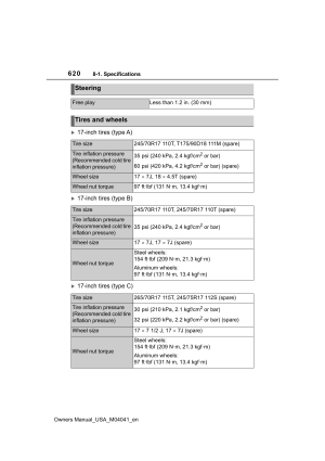

Tire Pressure Specifications by Configuration
17-Inch Tire Options
17-Inch Type A Configuration
| Specification | Value |
| Main Tire Size | 245/70R17 110T |
| Spare Tire Size | T175/90D18 111M |
| Main Wheel Size | 17" × 7J |
| Spare Wheel Size | 18" × 4.5T |
| Main Tire Pressure | 35 psi (240 kPa, 2.4 bar, 2.4 kgf/cm²) |
| Spare Tire Pressure | 60 psi (420 kPa, 4.2 bar, 4.2 kgf/cm²) |
| Wheel Nut Torque | 97 ft·lbf (131 N·m, 13.4 kgf·m) |
17-Inch Type B Configuration
| Tire Size (Main & Spare) | 245/70R17 110T |
| Wheel Size (Main & Spare) | 17" × 7J |
| Wheel Nut Torque - Steel Wheels | 154 ft·lbf (209 N·m, 21.3 kgf·m) |
| Wheel Nut Torque - Aluminum Wheels | 97 ft·lbf (131 N·m, 13.4 kgf·m) |
17-Inch Type C Configuration
| Main Tire Size | 265/70R17 115T |
| Spare Tire Size | 245/75R17 112S |
| Main Wheel Size | 17" × 7½J |
| Spare Wheel Size | 17" × 7J |
| Main Tire Pressure | 30 psi (210 kPa, 2.1 bar, 2.1 kgf/cm²) |
| Spare Tire Pressure | 32 psi (220 kPa, 2.2 bar, 2.2 kgf/cm²) |

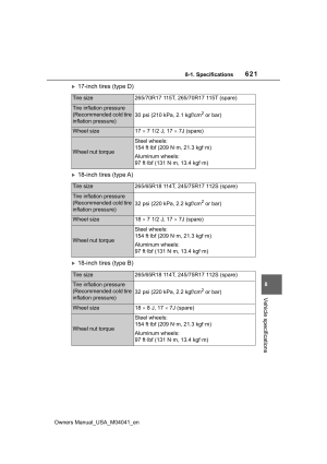

17-Inch Type D Configuration
| Tire Size (Main & Spare) | 265/70R17 115T |
18-Inch Tire Options
18-Inch Type A Configuration
| Main Tire Size | 265/65R18 114T |
| Main Wheel Size | 18" × 7½J |
18-Inch Type B Configuration
| Main Wheel Size | 18" × 8J |

Tire Maintenance
Checking Your Tires
Treadwear Indicators:
- Check if the treadwear indicators are showing on the tires
- The location of treadwear indicators is marked by "TWI" or similar symbol molded into the sidewall of each tire
- Check the tires for uneven wear (excessive wear on one side may indicate alignment issues)
- Check the spare tire condition and pressure if not regularly rotated
Maximum Load of Your Tires
When replacing tires, verify that the replacement tire meets your Tacoma's load requirements:
Check that the number given by dividing the maximum load by 1.10 of the replacement tire is greater than 1/2 of the Gross Axle Weight Ratings (GAWR) of either the front axle or the rear axle, whichever is greater.
- For GAWR information: See the Certification Label on your vehicle
- For the maximum load of the tire: See the load limit at maximum cold tire inflation pressure mentioned on the sidewall of the tire
