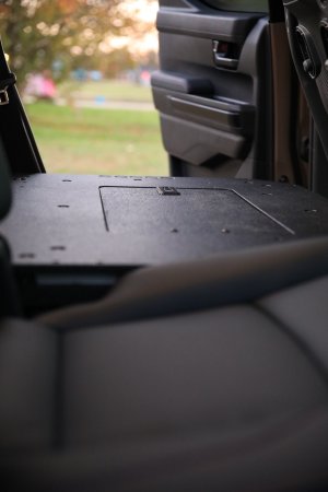

Here’s what it looks like installed:

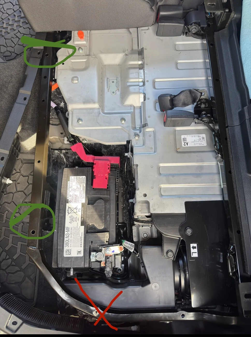

- They got essentially every step right and I’d follow what they say up until you start removing the trim pieces.
- If you’re only installing the 60% delete, you don’t have to remove the single seat on the passenger side, but it would probably make installing the final bolt a little easier if you don’t have nimble hands.
- You don’t have to remove the plastic trim that wraps around the entire bottom of the passenger seats if you’re only doing the 60% delete. You can just remove it all the way up until the middle 3 holes are exposed. I’ll assume the same will go for the 40% as well, I just haven’t bought it yet.
- DON’T DRILL IN THE 3 HOLES THEY HAVE CIRCLED IN THEIR INSTRUCTIONS
- You only need to drill in the front 2 holes they have circled in red for the 60% delete. If you drill in that third hole that isn’t in-line with the other two, you will be pointlessly making the hole bigger for no reason. Ask me how I know.
- With where the T bar slides are on the plate, it doesn’t allow you to put a spacer there. They only provide two spacers anyways, so why would they have 3 circles highlighted?
- The 23/64 drill bit size they recommend isincorrect. Use a 27/64 drill bit and the drilled holes will then fit the riv-nuts perfectly. Again, ask me how I know what size is too big when installing.
One thing I’m not too fond of is that the battery is just exposed under the little cubby. With wet dogs or snow gear etc, I can already see water leaking down and creating an issue. I’m on the hunt now for a solution to protect that area.
By no means am I bashing them or their product, I think it’s great & I’m pumped to have gotten it for a great deal as i found one for sale. I hope this helps someone out there!
