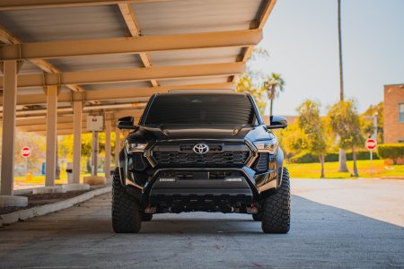

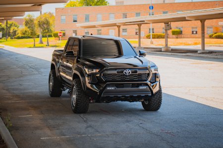

I’ve seen a lot of people asking about fitting 33’s on the 4th gen Tacoma without a lift, so I wanted to share my setup and experience.
Truck:
2025 Tacoma TRD Off-Road
Wheel & Tire Setup:
  • Wheels: Lock Off-Road Wheels
  • Size: 17x9
  • Tires: 33x12.5
  • Suspension: Stock
Fitment notes:
To make the 33x12.5 tires fit properly, I had to remove the front crash bars. After removing them, the clearance improved a lot and the setup works great.
So far:
  • No major rubbing during normal driving
  • Good clearance while turning
  • Truck still drives great on the road
The stance is way better than stock and the truck feels more capable on trails even without a suspension upgrade yet.
I recently tested the setup on its first trail run, and the truck felt super smooth and stable with the bigger tires.
If anyone is considering 33’s on stock suspension, feel free to ask questions — happy to share more details 🤙

Great looking truck!! I have the Lock Mojaves on my truck and man am I in love with their wheels. Stance looks really good too. I am on 35s and had to remove the crash bars too, I still rub just a bit at full turn.
