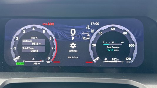

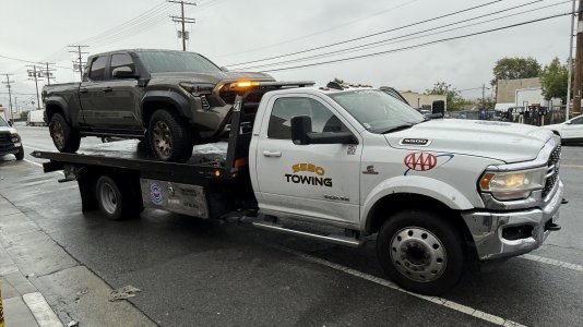

Bought a new 2026 Tacoma Trailhunter about 6 weeks ago. Currently at 355 miles.
I had a professional install two Motohorn train horns, Gasoray kill switch, fang lights, two auxiliary lights, and a heads-up display.
I dropped it off to get PPF wrapped. When I picked it up and started it, the RPMs were fluttering up and down, almost dying, then fluttering again. When I tried to leave the parking lot, I had no acceleration at all and had to coast to a stop.
The dash showed:
• Hybrid System Stopped
• Steering Power Low
Dealer scanned it and the hybrid battery is only showing 12%. The tech said he’s never seen this before and there are no diagnostic codes stored.
He explained that because the kill switch completely powers down the entire truck, the system can’t keep any codes stored — the system needs to stay powered on / running in the background for diagnostic codes to remain.
They’re telling me they might need to order a special Toyota hybrid battery charger, that I may have to pay for a license to use it, and that I shouldn’t expect the truck back by this weekend.
They also want me to approve 4 hours of diagnostics ($920) before they’ll even start working on it.
Has anyone seen this on a new hybrid Tacoma, especially with a kill switch installed?
Any advice is appreciated.

Just got it back. They dropped the price from $920 to $500. It took a while to get the hybrid battery to hold a charge. They got it to hold a charge last Saturday, so a week in the shop. Then this week was stress testing. The did a few laps and the check engine light came on. The codes came back as a faulty catalytic converter. Part came in yesterday & I just picked it up an hour ago 😎
Here’s the final outcome:
CUSTOMER STATES HYBRID SYSTEM MALFUNCTION PLEASE CHECK AND ADVISE// WONT READY ON
NOTE VEHICLE HAS SEVERAL NON FACTORY ADD ON'S THAT MAY INTERFERE WITH ENGINE/HYBRID AND OTHER SYSTEMS OPERATIONS.
(1) TRUCK HAS A REMOTE POWER SOURCE CUT OFF SWITCH THAT CUTS OFF POWER SOURCE SUPPLY TO VEHICLE. (HAS TO BE REMOVED DUE (KAM) KEEP ALIVE MEMORY WILL NOT FUNCTION. (2) 12V BATTERY KEEPS DROPPING VOLTAGE UNDER 12 VOLTS. (3) VEHICLE WILL NOT READY ON, OBSERVED DATA ON HYBRID BATTERY (SOC) VOLTAGE KEEPS DROPPING AFTER TRYING TO START, NOTE IF TOO MANY START UP EVENTS HV BATTERY MAY DEPLETE, TO THE POINT WHERE IT WONT ATTEMPT TO START ANYMORE (BE ADVISED) (4) PERFORMED HEALTH CHECK CAN NOT LOOK INTO INTERNAL CODES,
CODES VEHICLE WILL NOT SHOW ENGINE, HYBRID OR HYBRID CONTROL CODES OR INTERNAL ROB'S CODES. (5) VEHICLE HAS WIRING ADDED AND RELAYS FOR CONTROLLING NON FACTORY ADD ON'S, FOUND WIRE FOR GROUND? ATTACHED TO VEHICLE'S ENGINE CONTROL MODULE, HAVE NO IDEA FOR OPERATION ON THESE ADD ON'S, ALSO VEHICLE HAS INTER PHASE MODULE ADDED TO DC 3 CONNECTOR THAT MAY AFFECT COMMUNICATION TO ON BOARD DIAGNOSTICS. VEHICLE WOULD
NEED TO BE BROUGHT BACK TO FACTORY SPECS, THEN DIAG OF 3.0 PLUS ADVISE. NOTE MAY REQUIRE EXTENSIVE DIAG OR DOWN TIME.
REMOVED POWER CUT OFF FROM 12V BATTERY SOURCE. INSPECTED SYSTEMS AND OBSERVED DATA COMMUNICATION LOST FIRST AT SMART KEY SYSTEM AND THEN AT ECU SECURITY KEY, FOUND A MISSING FUSE AND A BLOWN FUSE AT DRIVERS POWER BLOCK. RE ESTABLISHED
COMMUNICATION WITH ALL SYSTEMS, RESET AND ROAD TEST.
NOTE DID NOT REMOVE ANY ADDED NON FACTORY COMPONENT OTHER THAN 12V WIRELESS POWER CUT OFF DEVICE. IF ANY MALFUNCTION OR CODES TRIGGERED BY SUCH ADDED ITEMS MAY REQUIRE DIAG TIME
