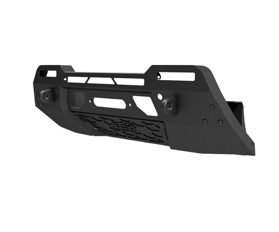

The Covert is a low-profile steel bumper that tucks up under the factory grille line. It doesn't scream aftermarket — it looks like it belongs on the truck. That was a big reason I went with it over some of the bulkier options on the market. From a distance, you almost don't notice it's not stock. Up close, you see the steel, the recovery points, the integrated winch mount, and you realize this thing means business.
Build quality is solid. The welds are clean, the powder coat has held up through a year of trail abuse with no flaking or chipping, and the steel itself has taken hits without bending. I've dragged this thing over rocks at King of the Hammers, through tight lines in Sedona, and on every trail run in between. The bumper has done its job.
It also maintains the factory sensors — parking sensors, front radar — which is critical on a daily-driven truck. That said, the sensor integration is where the story gets complicated.

CBI Covert winch tray. Image: CBI Offroad
The CBI Covert is marketed as compatible with "most winches up to 10,000 lbs." I went with the Warn Zeon 10S — an industry-standard synthetic rope winch that should be a natural pairing.
It fits. Barely.
The Zeon 10S is a tight squeeze in the Covert's winch tray. The integrated solenoid on the Zeon 10S makes the winch body wider than a lot of other options, and in this bumper, every millimeter counts. To make it work, the sensor wiring had to be spliced to create enough clearance for the winch body. That splice was done by the shop that installed it — Doetsch Offroad in Chandler, Arizona — and it worked initially.
The bigger problem was clearance between the winch and the coolant line. On the 4th gen Tacoma, the coolant hose runs right behind where a winch sits in the Covert's tray. The Zeon 10S sits close enough to the line that over time, vibration and trail impacts caused the winch body to rub against the coolant hose. I didn't catch it until I was dealing with a coolant leak.
If you watch the CBI install video above, you can see how tight the space is behind the bumper. What the video doesn't show is what happens after thousands of miles of off-road use — the winch shifts, the hose flexes, and eventually they make contact. The Tacoma4G install thread has close-up photos of this exact area that are worth studying before you commit to a winch choice.
The repair bill: $1,500. That's a coolant line replacement on a 2024 Tacoma with aftermarket armor in the way. Not fun. Doetsch Offroad did engage and helped get the coolant line fixed, which I appreciated. But they did not take any ownership of the install that caused the problem in the first place. I paid for the entire repair out of my own pocket — parts, labor, everything. When your install shop puts a winch in too tight and it wears through a coolant line, you'd expect them to stand behind the work. That didn't happen.
This is a fitment issue that CBI and the aftermarket community are aware of. If you're running a Zeon 10S in a Covert bumper, check your coolant line clearance. If you're about to install, consider a winch with an external solenoid (like the Warn VR EVO or a Badland Apex) or a slightly smaller form factor. The Tacoma4G forum poster used a Badland winch with a separate solenoid box and it cleared with room to spare. The extra 30 minutes of research could save you $1,500.

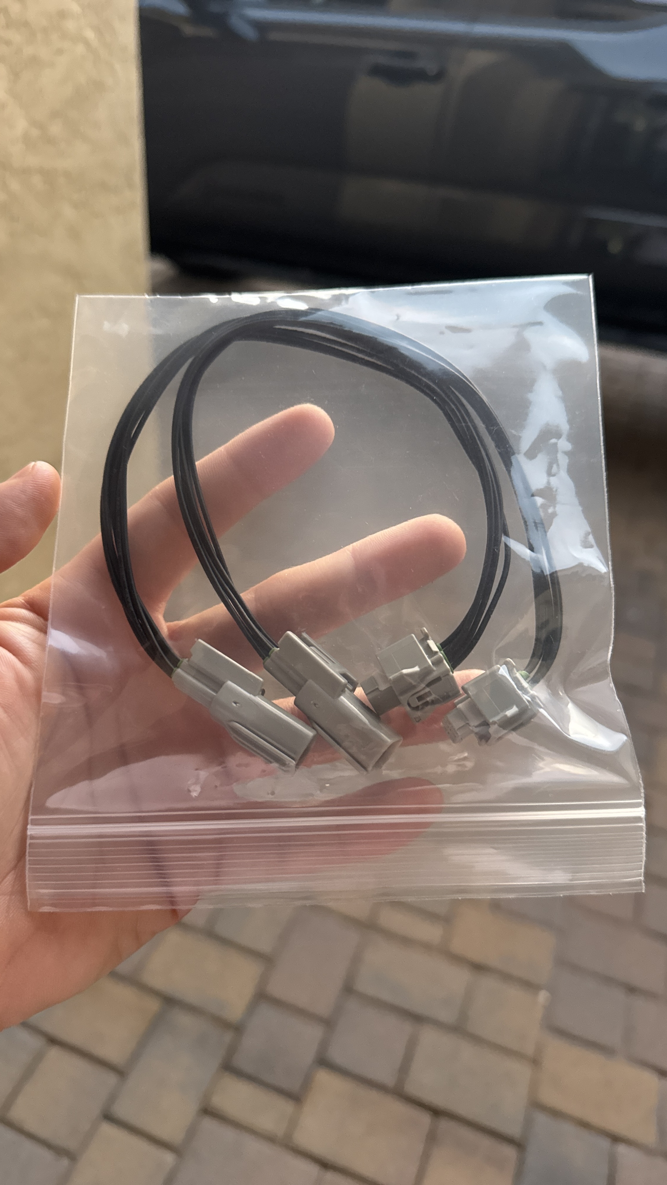

Here's where the story turns. I reached out to my contacts at CBI directly, and they didn't dodge it. They acknowledged the splicing issue and told me about a new product they'd been developing — a plug-and-play sensor harness that eliminates the need for any wire splicing. It connects directly to the factory harness with OEM-style connectors.
They sent it over with a hand-signed letter from Nathan and the CBI/Prinsu team acknowledging the hassle and a discount code for future products. That's how you handle a product issue — you own it, you fix it, and you make it right.
The install does require a new factory harness from Toyota (about $150), since the original was spliced. Once I get the factory harness, the new CBI connector mates directly — no cutting, no soldering, no hoping the splice holds through the next rock garden.
This is the kind of thing that turns a frustrated customer into a long-term partner. CBI didn't pretend the problem didn't exist. They engineered a solution and shipped it to me before I had to ask twice. That matters more than any spec sheet.
