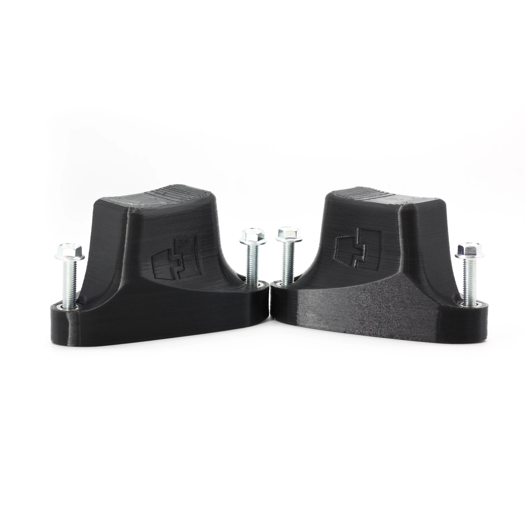

We’re thrilled to announce that Perry Parts is now offering bump stops for the 4th Gen Tacoma!
If you’re new to our products, we specialize in innovative designs like our patent-pending air damping bump stops. These stops dissipate energy in a way similar to hydraulic bump stops, but without the use of oil.
Our design has been third-party verified to shed up to four times more energy than some of our competitors, making a noticeable impact on your vehicle’s off-road handling and ride quality. Every product is rigorously tested on our in-house suspension dyno, and these bump stops have been validated to endure 100,000 cycles at over 2,000 pounds of force.
For the 4th Gen Tacoma, we’ve fine-tuned these bump stops specifically to complement the truck’s weight distribution, ensuring optimal ride quality and performance.
You might be surprised how often your bump stops engage on the trail—and how much upgrading them can transform your ride experience.
